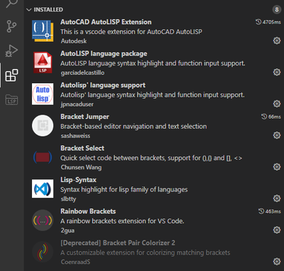

Message 9 of 11
paullimapa
these are the extensions I currently have loaded:
