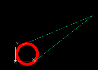

We are using a routine that works well, if you run the routine from start to finish.  If you have to hit the "escape" button to exit out of the routine, it will crash on you.  The layers will not revert and for some reason, the osnap setting will reset to "0" layer.  From what I have read, the error code I have written should reset all local variables to the start of the program.  Could someone look at it and tell me how to fix it?  I already know I need to stop using a donut command and use a block instead, but have not had the time to update.

Is it supposed to draw something like this? .. if so all I did was localize your variables and it worked.
(defun c:bc (/ *error* bcerr do don oldlayer oldor oldos oldsc pt1 pt2 temperr)

yes, it is supposed to look like that.  The problem is after you select the first point, but before selecting the second point.  If you hit the escape button the layer will stay on "strut_leg" instead of reverting to the current layer and the osnap setting will be changed to "0" instead of the current setting.  Not a big deal for me, but frustrating and time consuming for some of my weaker Acad users.
Message 4 of 18
Draftsman13
I should mention I tried your solution and am still having the same issue.
I should also mention we are using AutoCAD 2016 full version

Try this:

Message 6 of 18
Kent1Cooper
Or, with less of a wholesale re-write, these may not fix everything, but they caught my eye:
Change this inside bcerr:
(command "_.undo" "_back")
to this:
(command-s "_.undo" "_back")
In Acad2016, you should be getting an error message about using (command) in the *error* handler, suggesting this change.  That's probably cancelling the rest of *error*, so those other things don't get reset.
Change this:
(setq *error* bcerr) ; restores original error ; bcerr isn't the original!
to this:
(setq *error* temperr) ; restores original error
Kent Cooper, AIA
Message 7 of 18
Draftsman13
This does solve the error issue.  However:
1. I do not understand what is written.  My coding ability is really just glorified macros.
2. It removes some of the functionality of the original command.  Sometimes we just want the circle and not the tail.  This re-write does not allow for that.
Thank you for the responses, tho.
