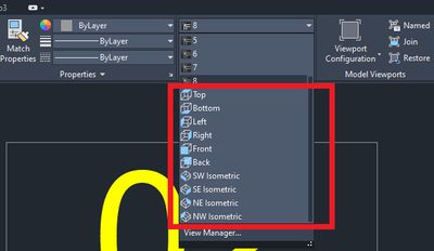

Hi there,
I would like to be able to remove the Preset Views from the list, as I want to work only with my own list.
I would greatly appreciate your help

Unfortunately, these preset views are built-into the AutoCAD CUIx as well as the VIEW GUI.
But if you execute the command line version -VIEW, you won't see any of these view names.
So one way to get around this is to customize via lisp & dcl your own drop down or list window.

Q: don't your custom named views always appear at the top of the list all the time?

Yes I agree Paullimapa
that's the way to get around this is to customize via lisp & dcl your own drop down or list window.
Thanks.

Use the vpoint command with custom defuns.
(defun c:vp3 ()(command "VPOINT" "1,1,1"))
 try 1,1,0 1,0,1 and so on.
