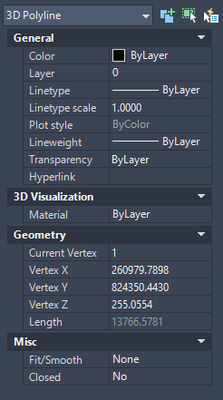

Attached is the 3dpolyline in dwg. it is showing the first vertice to 4dp in properties.
The start portion of the output at the bottom shows the output from the lisp
