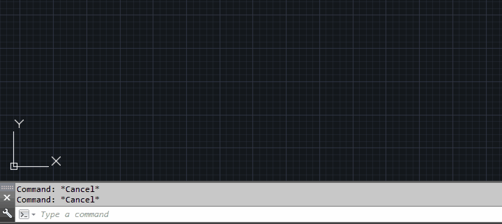

Hi people!!!!
I´m trying write a code that insert a block in an each point of vertex, but all vertex has the same number (10) and the block just insert in the first point.
see my code:
(defun c:test ()
(setvar "osmode" 0)
(setq selecao_geral (ssget))
(setq s1 (ssget "_p" '((0 . "LWPOLYLINE") (8 . "F-SC-GREIDE"))))
(setq pline (cdr (assoc 10 (entget (ssname s1 0)))))
(command "_insert" "C:/Users/alexa/Desktop/Alexandre/12.LISP'S PARA AUTOCAD/BLOCOS/PIRULITO" pline "1" "1" "0" "XX")
(princ)
how can i insert blocks in all vertex?
Please!!!!
Replies (10)
Message 2 of 11
Ranjit_Singh
Maybe like this
(defun c:test  (/ ctr s1)
  (setvar "osmode" 0)
  (setq s1  (ssget  '((0 . "LWPOLYLINE") (8 . "F-SC-GREIDE")))
        ctr 0)
  (repeat (sslength s1)
    (foreach i  (cdr (reverse (vl-remove-if-not 'listp (mapcar 'cdr (entget (ssname s1 ctr))))))
      (command "_insert" "C:/Users/alexa/Desktop/Alexandre/12.LISP'S PARA AUTOCAD/BLOCOS/PIRULITO" i "1" "1" "0" "XX"))
    (setq ctr (1+ ctr)))
  (princ))
Also note that you do not need to get selectionset and then call previous. I am not sure of the "XX" argument, may be that is for some attribute.insert_blocks.gif
