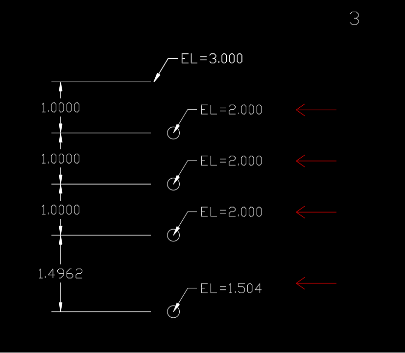

I'm looking for some help editing a lisp
I have Lisp and I want some help.
After Command asks Next level Position, I want to select object of the all circle.
And get results as in the picture
thanks !

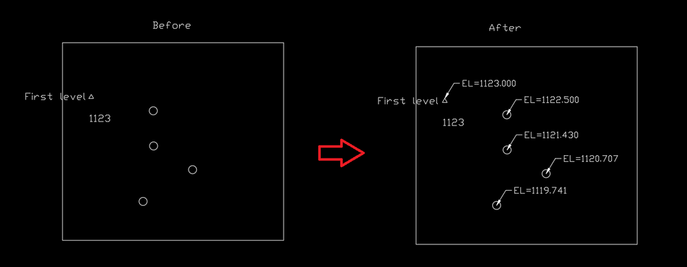

Remind me again what the lisp code is about? can you please post the equivalent drawing sample of the imaghe you posted and show the "correct" results.
Message 12 of 15
chan230984
@pbejse
Sorry I am not good an English
Please see Picture Below
Message 13 of 15
pbejse
