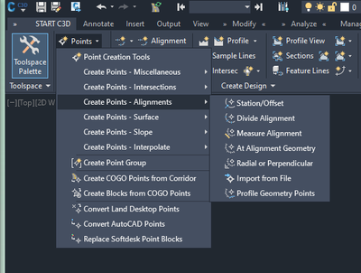

No, unfortunately, it's not possible. Not in CUI, not with a lisp.
BTW We can see that in C3D but it's done programmely so it's just a single item in the cui.
