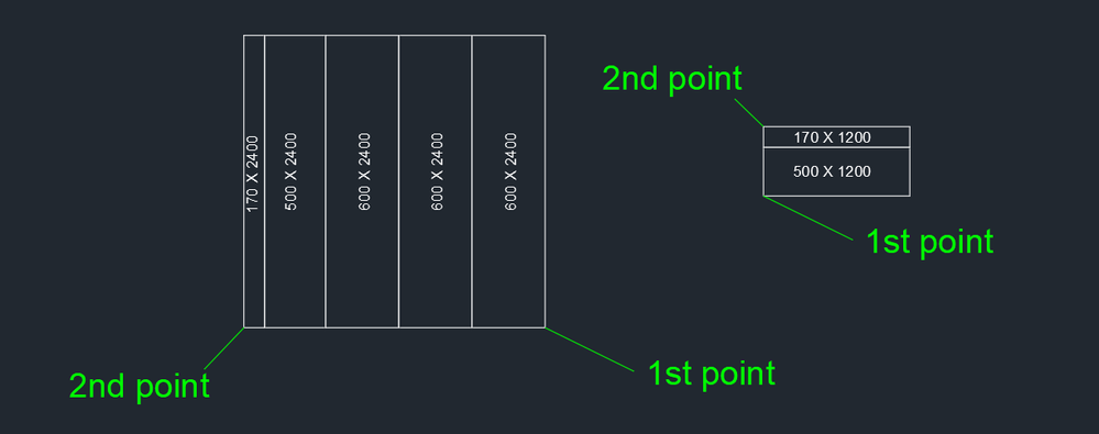

1. can you change the 1st and 2nd point as shown in image
2. their is problem when the distance between two point is 670 then rectanle of witdh 500 and 170 has to come but it draw 600 width rectangle
3. if i have to draw rectangle paller to y axis but which is not working

ganeshgatkul1
for rotating text i have to change
(50 . 0.)
to this
(50 . 1.57.)
