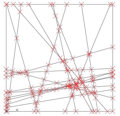

surfer96
Yes, I'm looking for the total of distances between the total of intersection points.
The way to the code could be like:
  • create all random lines in AuroLISP
  • find the total of intersection points from the total of lines
  • calculate the distance from "point1",  "point2" etc. to all other points
  • combine "point1"-, "point2"- etc. distances to lists like: (dist p1-p2, dist p1-p3, etc.), (dist p2-p3, dist p2-p4, etc.)
  • combine all p1-, p2-, etc. distance lists to one total distance list containing the total of distances
  • sort the total distance list
  • define the smallest, second smallest, largest and second largest members of the list as variables
  • define a lower and upper boundary for a range (e.g. 2 to 50) of distances accepted
  • the smallest and second smallest distance must not be smaller than the lower boundary (e.g. 2)
  • the largest and second largest distance must not be larger than the upper boundary (e.g. 50)
  • the boundary condition highly probably not being with the first set of lines...
  • define a while loop with the lower and upper boundary as restrictions and restart from scratch
It will take millions of rounds through the loop which doesn't matter, provided the condition is finally fulfilled.
The point-based distance calculation is a tool to control the minimum and maximum of the areas of the resulting polygons in the pattern. The two min- and max-values for the distance indirectly define min- and max-equilateral-triangles and therefore min- and max-areas.
The sample drawing is a 100-100 mm box with 9 horizontal and 9 vertical inner random lines from edge to edge.
If the lines were regularly distributed in the box, all distances between all points would be 10 mm.
In the end, what I'm looking for is some kind of controlled chaos: basically accept a random distribution, but slightly control it by defining 2mm and 50mm as "chaos-boundaries".
I know this is a lot of input, but maybe the solution can be elaborated step by step. And the first necessity will be to get a total distance-list. I've joined an attachment sample with the box and the random lines. The so called maximum length for all lines can be removed from the sample. At the moment it is set to 140, so it does not have any impact.Random Lines / Regular Lines / Max AreaRandom Lines / Regular Lines / Max Area

surfer96
I used Lee's functions and got all intersection points between all lines.
Is there any routine to calculate all distances between all intersection points as well?Unbenannt.JPG

surfer96
Your code helped a lot to find all distances between all intersection points. I flattened the outcoming lists to one distance list using parts of LM:flatten.
The point distance appoach turned out to be slightly faster compared to breaking or sclicing objects and then evaluating their areas or volumes.
But looping is still not fast enough for my purposes. Maybe I'll give it a try with VB.NET...
