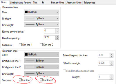

I have 2 problems when using the Dim edit lisp
1. I'm using this lisp to edit dim extension line. when working with dims without extension lines, it will cause dim to jump and change values. Is there any way to fix this problem of lisp(image attached).

hak_vz
@Vuxvix
Create two separate dimension styles, one with extension lines turned on ("ISO-25"), other with turned off ("ISO-25-no-extensions"). For style "ISO-25-no-extensions" in style definition select
If your dimension lines with extension lines turned on are defined with dimension stile named, let say "ISO-25" to apply changes only on them and leave other untouched, you should modify selection filters . Apply to both your functions.
Replace
(SETQ SS (SSGET))
with
setq ss (ssget '((0 . "DIMENSION") (3 . "ISO-25"))))
