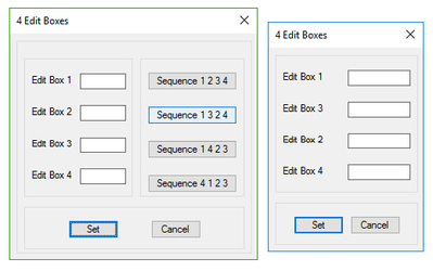

Hello guys,
I have a dialog with four edit_box and when I press TAB from the keyboard the cursor moves from one to another automatically.
How can I rearrange the tab sorting between these attributes to the order I want ?
Thanks in advance.

komondormrex
this is a rough outline of what i meant

Message 18 of 18
J-Rocks
Thank you for your clear narrative solution, will try it as soon as possible.
