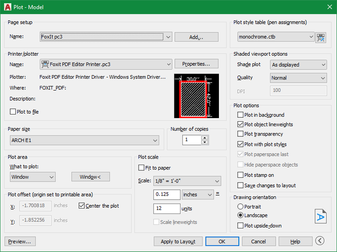

Hi Everyone, Good day to all, Im a beginner with lisp knowledge
I'm trying to customize a LISP routine to create PDFs using my own .pc3 and ctb file — specifically, I'm using "Foxit PDF Editor Printer.pc3". I tried replacing the default printer and setting a custom paper size, but the code isn’t working as expected.
(defun c:PDF ( / cm )
   (setq cm (getvar 'CMDECHO))
   (setvar 'CMDECHO 0)
   (command "_.-plot" "_y"
       (if (= 1 (getvar 'TILEMODE)) "Model" (getvar 'CTAB))
       "AutoCAD PDF (High Quality Print).pc3" "ARCH D (24.00 x 36.00 Inches)"
       "_M" "_L" "_N" "_E" "_F" "_C" "_Y" "monochrome.ctb" "_Y"
       (command "_A")
       (command "_N" "_Y")
   (command "_N" (strcat (getvar 'DWGPREFIX) (vl-filename-base (getvar 'DWGNAME))) "_Y" "_Y")
   (setvar 'CMDECHO cm)
   (princ)
(vl-load-com) (princ)
When I replace the default .pc3 file in the LISP code with my own (Foxit PDF Editor Printer.pc3), instead of plotting automatically, it starts asking for every input again — like paper size, plot area, etc
 As below 👇

paullimapa
As I mentioned in msg 6 & 16 because you’re using a custom pdf device like Foxit instead of the built in AutoCAD devices like Dwg To Pdf.pc3 that Save As pdf name dialog box will appear. Also any attempts to customize to pdf filename is lost.

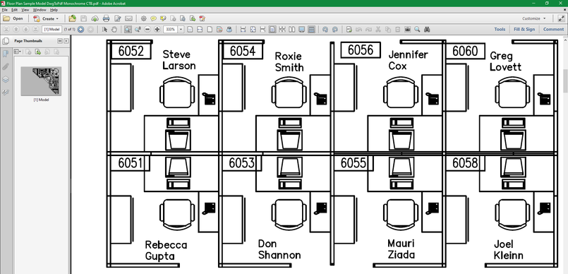

FYI: Attached is the test process I followed through to demonstrate my point using AutoCAD's built-in DWG To PDF.pc3 vs FoxIt.pc3
Both pdfs are generated from the same Floor Plan Samples.dwg that comes with AutoCAD and monochrome.ctb
Snapshots of both PLOT windows:
Snapshots of both PDFs zoomed into same area at 333%:
Conclusion: I don't see any difference in "black lines darkness"

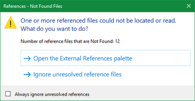

I dnloaded & opened your sample dwg: #200451_RS-01-01D_APP_00.dwg
The following alert window appeared:

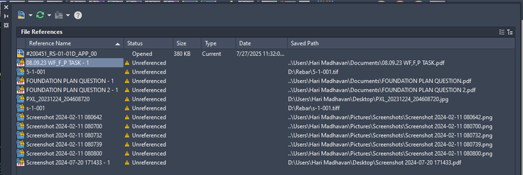

Opening the External Reference palette the following shows Unreferenced:

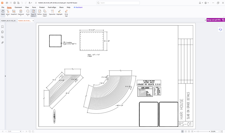

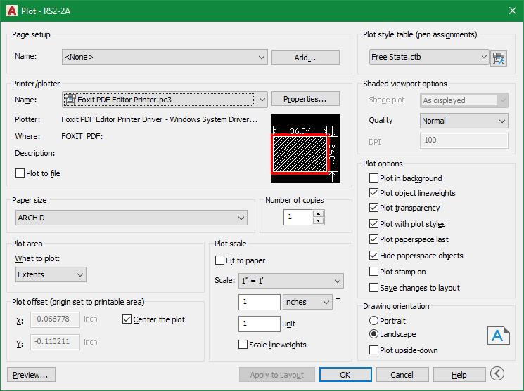

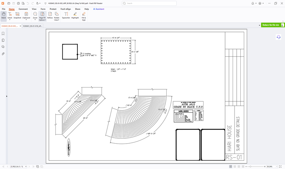

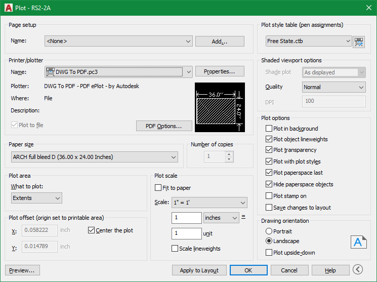

I then generated from the current layout RS2-2A the following Pdfs:
PLOT window using Foxit PDF Editor Printer.pc3 to generate #200451_RS-01-01D_APP_00 RS2-2A (FoxIt).pdf
PLOT window using AutoCAD's buit-in DWG To PDF.pc3 to generate #200451_RS-01-01D_APP_00 RS2-2A (Dwg To Pdf).pdf
Now opening both pdfs (attached) using Foxit Reader I've produced the same conclusions as I stated in my previous responses.
There are no line weight differences (darker or lighter) between using the paid version of FoxIt vs AutoCAD's built-in free Dwg To Pdf.pc3
So I would stay with AutoCAD's Dwg To Pdf.pc3 to successfully batch plot running the lisp code which also allows you to specify the generated pdf file names.

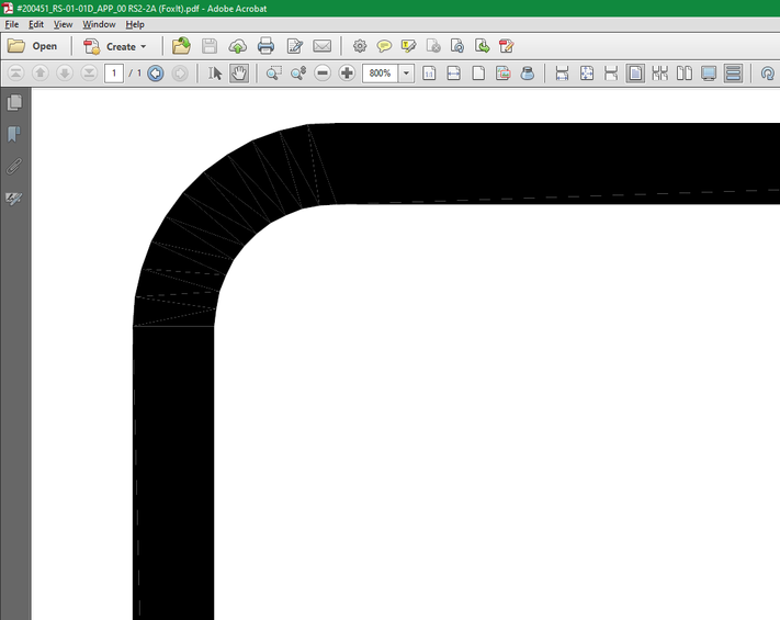

Hi sir, It seems but if you closely look at the filleted area there is flar effect you can notice. And dot leader side also.
Message 32 of 44
paullimapa
please mark up in red exactly the area you see that's different between the two pdfs because I cannot see the difference looking at your screenshot.
Paul Li

Message 33 of 44
harimadhavan66
Hi sir, I have attached the screenshot with highlighted.
Message 34 of 44
paullimapa
The problem is caused by the Foxit Reader.

Ohh okey sir. If you look closely at the line's darkness, with foxit is lighter and DWG to pdf would darker that's the main issue. Any solution sir. My doubt about the calibration settings in .pc3 file would reason.

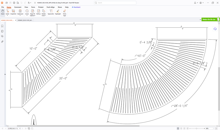

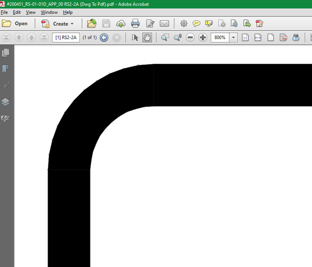

Message 36 of 44
paullimapa
Actually looking closely the Dwg To Pdf.pc3 PDF darkness completely fills the area.
But FoxIt 's PDF filled darkness is incomplete with lots of white lines.
So my preference is still Dwg To Pdf.pc3.  But this is looking more and more like a subjective exercise.
In conclusion, you can continue to use your paid version of FoxIt.
But as I stated over and over again you won't be able to use lisp code to automate the pdf generation process.
So the choice in the end is yours.

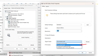

I find the solution. PDF name might restricted by .pc3 file. To resolve change the save location to default would resolve the issue (See snap-1). Now I improve some part. To loop through and name the pdf automatically. But the issue is pdf naming would applied for .plt file. But it should apply for .pdf. If it get fixed it super good.

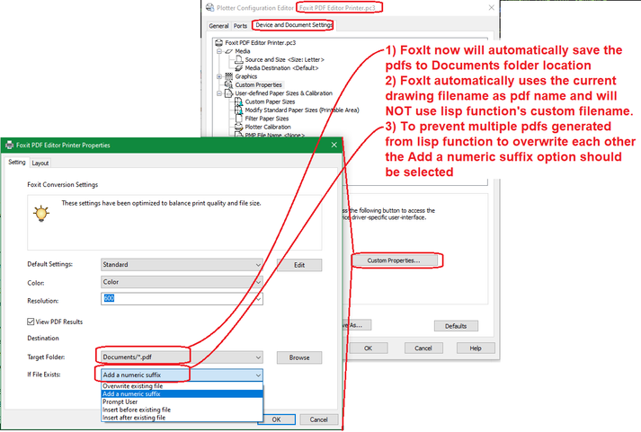

Here are my observations:
(1) When you make these changes as you stated in your post to FoxIt Pdf Editor Printer.pc3
(2) In the plot sequence when you select plot to file, AutoCAD will create the .plt files as you've observed. But the plt files created do NOT have any content so thus the file size is 0. So even after renaming the .plt to .pdf those files are useless because FoxIt will follow the .pc3 Custom Target Folder settings as discussed in (1).
(3) In case you're curious here are the changes I made to your PltFox2.lsp:

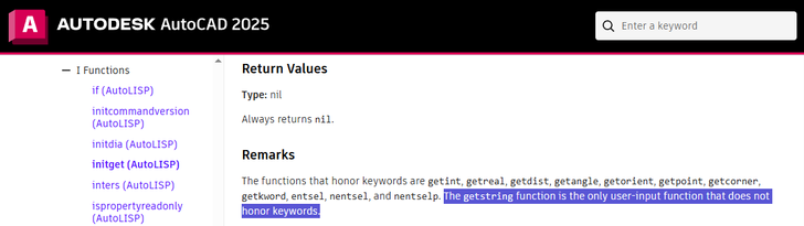

c) The initget function does NOT have any impact on the getring function:
So the following line should be commented out before running getstring:
  ;; Prompt user for filename format
;  (initget 1) ; initget function has no impact on getstring function

But the conclusion is still the same. Though you've resolved the issue of the plot filename request window from appearing, there's no way using lisp to customize different locations telling FoxIt where to create the pdf and also no way to change the name of the generated pdf.
