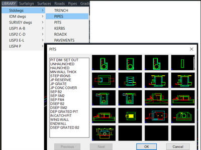

I use mnu files all the time as they can be edited with notepad. Just use menuunload  & menuload. You can have POP and toolbar menu's using mnu. a Ribbon has to be done with the CUI. I have used lisp to help make a mnu writing repeating code for say insert blocks.
You can have images in a POP  menu when making choices.
