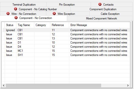

The Toolbox for DCL creation uses basic controls eg edit_box etc. AutoCad Electrical utilises more advanced controls such as List Views, Tabs Sheets etc. Is there a way to harness these controls in our own LISP routines without the use of external libraries? Below is an example of a Dialog I would like to produce using DCL with AutoLisp
Thanks in Advance
Mark
DataGridView and Tab Sheet Extracted from AutoCad ElectricalDataGridView and Tab Sheet Extracted from AutoCad Electrical

It can be done but a lot of work. This a click button for more options.
CodeDing
@mark.electricaldesign ,
THIS source says No, but you can try OpenDCL.
THIS source appears that @Sea-Haven  has already been here and answered the same question similarly.
THIS source gives a mention by Lee Mac that it could be done with an 'image_button' tile but would take a large amount of work (which most likely won't be worth the hassle) (which is what I assume sea.haven means when he says it would be a lot of work).
So it's definitely beginning to appear that another approach would be worth a shot here. Sea.Haven brings a valid solution to the table IMO..
