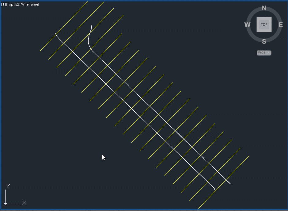

Hello everyone,
I've found a great piece of AutoLISP routine from Lee Mac's website that helps me create a point at every intersection. However, it doesn't seem to work when I have many polylines at different elevations. How should the code be modified? I can't really flatten them since I want the points to be snapped to the elevated lines.
(In the attached sample drawing, the 2D yellow lines are at elevation 0, and the white lines are at different elevations. The points should be snapped to where they intersect, at the white lines' elevations.)

Two object intersect if they lie in same plane.
Since your lwpolylines have different elevations they don't intersect i.e there is only apparent intersection.
To find intersections create in separate layer copy of lwpolylines but with elevation set to 0 and find points of intersection in plane  Z = 0. Use that set of points and create vertical lines with start point x,y,0, and end point let say x,y,1000. In second run look for intersection of vertical lines and original lwpolylines to receive 3d point of intersection.

Kent1Cooper
The (intersectwith) method isn't going to do you any good if they don't actually intersect in 3D space.  I suggest that you just set APParent-Intersection mode as the only running Osnap mode, call up MULTIPLE and the POINT command, and go around picking at the apparent intersections.  I suspect it would be a lot faster than coming up with a way of making flattened copies, finding intersections with those, generating vertical Lines, and finding the actual intersections of those with the original raised-Z Polylines.  You'll need to Zoom in to get multiple APParent Intersections where white Polylines are very close to each other.
HOWEVER, I'm not sure what determines at which object's elevation a Point goes under APParent-Intersection Osnap mode.  In my quickie trial, they all went to the elevations at the white sloped ones, but it may be always at the place on the more-recently-drawn  of the objects involved.  That's always the white compared to the yellow in your sample drawing, but might not always be.
[And by the way, these shouldn't be drawn in Paper Space.]

oli-123
It seems like whichever is the top-most object, the apparent intersection will snap to that object's elevation.

hak_vz
If you only use lwpolylines, i.e in intersections there is no inclined lines or 3dpolylines then solution is simple.
To find an intersection read elevation from lwpoly object, create line object elevated to that Z, find intersection with lwpoly, and create a point. Then erase line object.
Please elaborate what you want to do with that points. Cross sections?

oli-123
I would be creating a label for each one of those points and display their elevation values.
I see what you're saying now. It's not as neat as what I would imagine, but that's one thing I can do. I'll have to try that out.

A quick and dirty is to use trim then get new end point save value, then undo to put back, not extensively tested.
Noticed your dwg has two lines at crossing yellow lines.
Message 9 of 11

Hi oli6QAF7,
Please try the following code which will determine the intersection point on the elevated polyline and insert a POINT object at the coordinate:

Oh wow, this works really well! I tried that on my main drawing, and I'm really happy with the result. Way better than what I tried to attempt.
Many thanks to everyone else for other suggestions.
