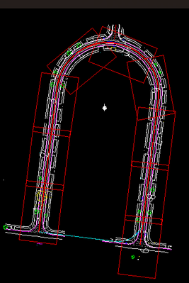

Hello
a LISP routine that create a new layout for each selected polyline (rectangle) in model space, and places a viewport zoomed to fit each polyline inside that layout:
  • select multiple polylines in model space
  • For each selected polyline:
                    A new layout is created.
                    A viewport is inserted and zoomed to fit that polyline.
                    The layout is named PolyLayout1, PolyLayout2, etc.

https://www.cadtutor.net/forum/topic/76216-create-layout-from-a-grid-in-model-space/#findComment-666...
This is the best programming in relation to placing each rectangle in layout and numbering each layout
But it still cannot rotate the sheets in the model to be parallel to the viewport, and adjust to the scale of the project, but it is still the best programming 50% of the heavy work done successfully!!!

Message 9 of 11
sigmmadesigner
Wow, It Rotated Beautifully, It Is Possible To Create The Viewport The Size Of The Selected Rectangle, If That Is Possible, If So. The Program Will Be A Rocket
Message 10 of 11
aridzv
@sigmmadesigner
glad it helped!!
actually,
you don't Create The Viewport to The Size Of The Selected Rectangle but the other way around:
draw a rectangle on the viewport,
copyclip it to model space and use it.
you can also scale this rectangle to known value.
the original is 1:1 and if you scale it by 5 it will be 1:5 etc'.
make sure you Draw the viewport and the rectangle from left to right.
This can be from top left to bottom right or bottom left to top right but must be left to right.
see attache video.
Message 11 of 11
Sea-Haven
I do the opposite of this, drawing the rectang based on desired dwg scale and the title block being used, which defines the mview size in a layout, matching the correct title block. See the image in post 2. As mentioned rectang's can be rotated and the viewport will reflect this rotation.
This movie is an example of making layouts. Its a specific version to make a single size layout. The result is 17 layouts. The flashing which normally does not happen it is to do with screen recording of the layouts being made. You can though see the rotation being done in each viewport.
