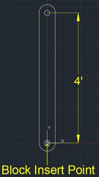

Hi all,
Trying to create a routine for a Path Array but routine wont even load to test. Looking for some help...
Goal:
Create an associative Path Array using a block from an inserted drawing (MyArray_block.dwg).
NOTE: I just have the drawing saved on my desktop so the path will need updating to match your address bar if you test it. Also,  I created a DWG file with a random polyline for testing called (Random_polyline_for_Array.dwg).
Steps:
-User either selects an existing Poly line OR creates a new one for the block to be arrayed to. The line will be based on the parameters of the given project so the length will not be know. Therefor the array must be adjustable.
-A drawing containing a block is then inserted and the block is then aligned to the Array Poly line at the start point.
-An associative array is created using the block at a distance of 4 feet apart. blocks will overlap. Length will be unknown which is why it needs to be associative. It can then be adjusted using the grip handle until it fits the project parameters.
Please see illustrations attached:
My block:

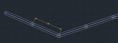

Example of a successful Path Array using this block and a random Polyline:

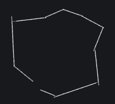

ВeekeeCZ
Well, I tried but hit the wall.
For some reason, PATHARRAY creates an array from the other end of the curve. Can't make it behave by the usual tricks I know. ‌‌It might take some time to figure this out that I don't have at the moment.
(defun c:APB ( / n d s i e p a b)
  (setq n "Myblock")
  (setq d 48)
  (if (setq s (ssget))
    (repeat (setq i (sslength s))
      (and (setq e (ssname s (setq i (1- i))))
	   (setq p (vlax-curve-getstartpoint e))
	   (setq a (angle '(0 0 0) (vlax-curve-getfirstderiv e 0)))
	   (setq b (entmakex (list '(0 . "INSERT") (cons 2 n) (cons 10 p) (cons 50 a))))
	   (initcommandversion)
	   (vl-cmdf "_.arraypath" b "" e "_b" p "_i" d "" "")
	   (entdel b)
  (princ)
Edit: I added a quick mod of my pseglen HERE  if you give up on arraypath, as I did. I would also recommend modifying your block the same way I did and adding a block to the searchable path.

You don't mention what method/routine you used to create the posted image, but it's evident that simply rotating the geometry in the block should solve the problem - this has been mentioned repeatedly.
As I already wrote, and no one has proven me wrong yet (I wish someone had), according to my tests, ARRAYPATH is not suitable for automating this process. It is unpredictable.
At this point, I see the only solution as creating the array manually, possibly using the routine I posted earlier.

ВeekeeCZ
With my already posted Pseglen and simple grrread CIRCLES func I can do something like this. If that makes sense to you and nobody else posts something more advanced, I'll make some adjustments and post it.
(defun c:fline ( / s p e p1 p2 l s f done)
  (setq f 48
	p (getpoint "\nSpecify point: ")
	s (ssadd))
  (while (not done)
    (command "_.line" "_non" p pause)
    (if (> (getvar 'cmdactive) 0)
      (progn
	(command "")
	(setq e (entlast)
	      p1 (getpropertyvalue e "StartPoint")
	      p2 (getpropertyvalue e "EndPoint")
	      l (distance p1 p2)
	      l (max f (* f (fix (/ l f))))
	      p (polar p1 (angle p1 p2) l))
	(command "_.lengthen" "_t" l (list e p2) "")
	(ssadd e s))
      (progn
	(command "_.join" s "")
	(setq done T))))
  (princ)

Hey all.
Sorry again for the late reply's. I really appreciate everyone's input and I think you have created great solutions.
BeekeeCZ. The Fline routine works great keeping the lines to 48" increments. When i run your fencing it always works out perfect. I also tried the array version along with Jayhar's additions (Thank you Jayhar for the curve direction addition). You guys are correct about the Array being a bit unpredictable. But when it does work it does give the ability for future adjustments. I will keep playing with that option as well.
BeekeeCZ: I combined your Fline and fencing code into one routine and it works. Thank you. I will attach for your review.  Let me know if you see any issues with my combo attempt. I just altered a few variable names so it hopefully wouldn't cause any issues. maybe not needed in the end.  ** The strange thing is that I cant just drop the LISP routine file into my drawing or load from the Visual LISP Editor and run. Both times it errors out. The only way i get it to load  is to copy the code into a new blank file in the editor, highlight all and say run selected.. Then it loads no problem....Any ideas why?
The last thing I will work on is bringing in the myblock and adding that for "an all in one" routine... hopefully. I think Lee mac had something I saw about that somewhere.
 I think this is a great solution everyone! Thanks!😁

ВeekeeCZ
Your combined version works if that's what you want, except that you copied-pasted my nickname, which was not a smart move. I've made just a few enhancements to be more efficient. If you want to autoload your block, just add it  between the searchable paths, and your issue is solved (can't place it there directly; it needs to be wblocked or just a simple dwg (w/o block) named with the block name.
Anyway, I've promised to make some enhancements so that you might try it. There are options there... the names are given, but the functionality is a bit different from the default behavior.
Message 13 of 23
