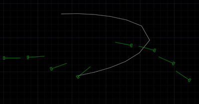

I work in the event industry so I have a lot of fencing to draw and I'm trying to make it as efficient as possible. I currently use a path array to generate my fencing quickly. It works great when its straight lines but as soon as there is a curve, I can't get my blocks to stay linked. (cfr. image )
Is there any solution to force 2 points of the block to stay on the path ? The closest solution I could get is to set the base point on the middle of the block so I can get the tangent but it's not perfect.

Hello @ColinRuy
This should be possible using lisp. Please check this thread: https://forums.autodesk.com/t5/visual-lisp-autolisp-and-general/multiple-constraints-along-array-pat...

I think the following should do what you want.
(defun C:BlocksOnSpline( / blockname delta d path osm endpar dToEnd n p1 p2)
;  Adds blocks along a spline with the base point and a secnd point of the blocck also on the spline.
; The second point is specified as a distance along the x acis of the block from the base point.
; L. Minardi 11/12/2024
(command "ucs" "w")
(setvar 'osmode 0)
(setq blockname (getstring "\nEnter block name: "))
(setq delta (getreal
	      "\nEnter distance to second point on x axis of block: "
(setq
  d	 0
  path	 (car (entsel))
  endpar (vlax-curve-getEndParam path)
  osm	 (getvar 'osmode)
(setq dToEnd (vlax-curve-getDistAtParam path endpar)
      n	     (atoi (rtos (/ dToEnd delta) 2 2))
(setvar "cmdecho" 0)
(setq p1 (vlax-curve-getPointAtParam path 0))
(repeat	n
  (setq d (+ d delta))
  (setq p2 (vlax-curve-getPointAtDist path d))
  (command "-insert" blockname '(0 0 0) 1 1 0)
  (command "_align" "last" "" '(0 0 0) p1 '(1 0 0) p2 "" "n")
  (setq p1 p2)
)					; end repeat
(setvar 'osmode osm)
(setvar "cmdecho" 1)
(princ)
Do you need another parameter to specify the distance between the blocks?

@ВeekeeCZ , It seems like extra work for the user to create the array of blocks in two steps.  I got the following results referencing the segmented curve generated by your code and then used the ARRAY PATH.
Here's a second attempt using PSEGLENGTH but with a distance of 1.201 !

Thanks @leeminardi and @ВeekeeCZ , I use a mix of both your commands and it works great. First I divide the curb with Bee's command, then I use Lee's to put the blocks on the divided spline. Dividing the spline first seems to correct the slight error I had using only Lee's command.
Thank to you both !
