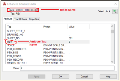

logan_ownbey5UKQZ
The title block is the only xref'd part. Attribute block is a separate part and is not xref'd.
When i call out the attribute, do i need to include the block that the attribute resides in?
See image below.

Message 25 of 32
paullimapa
yes, that's how the lisp code can first find the Block based on its Name and then locate the Attribute based on its Tag
