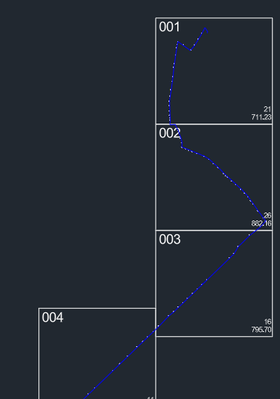

Good afternoon, I hope this post finds you well.
I have already tried to solve this with the help of AI, but I was not able to achieve the expected result, so I would like to ask for some guidance.
I have a block called VIEW. Inside this block, there are other blocks as well as some polylines.
My goal is to:
  • Count how many blocks exist inside the VIEW block;
  • Calculate the total length of polylines only within the internal area of the VIEW block;
  • Store these values in the attributes of the VIEW block itself.
Counting the blocks is not the main issue. The main challenge is:
  • Splitting the polylines exactly at the intersection points with the VIEW block boundary;
  • Correctly summing the length of all polyline segments that lie inside this boundary;
  • Restoring the polylines to their original state, so they are not left broken after the calculation.
I am attaching the DWG file to make the scenario easier to understand.
Has anyone dealt with a similar situation or could point me in the right direction to solve this?

I can imagine an approach, at least:
Select a VIEW Block, or select them all and apply what follows to each.
Given the plain rectangular shape and orthogonal orientation of it, using its bounding box, draw a temporary Polyline rectangle over its boundary.
Using its opposite corners for a Crossing window, find all Polylines within or crossing it.
Using the same for a Window [not Crossing] window, find all the BLK_COUNT Blocks inside it.
Using the (intersectwith) method, find the intersections between the Polyline(s) and the VIEW Block boundary.
If there are 2 intersections of the same Polyline, find the distances along that at each intersection with (vlax-curve-getDistAtPoint) , and from those calculate the length along the Polyline inside.  [There should be no need to Break the Polyline.]
If there are 2 Polylines with 1 intersection of each with the boundary:
  Determine whether the end of each Polyline that's inside is its start or its end;
  Calculate the distances of each portion from that end to its intersection with the boundary;
  Add the distances for a total length.
Delete the temporary rectangle.
Use (setpropertyvalue) to put the appropriate values [converted to Text strings] into the appropriate Attributes.
Potential complications:
If a BLK_COUNT Block straddles the boundary between two VIEW Blocks [for example, one between 001 & 002], it will not be seen by a Window selection for either VIEW Block.  But it would be seen by Crossing selections for both VIEW Blocks.  Maybe it should be done by Crossing, so that all are seen, and every BLK_COUNT Block checked for which VIEW Block it should be credited to.  But that check would logically be for whether its insertion point is inside.  Unfortunately, the BLK_COUNT insertion point is not in the middle.  That one that straddles 001 & 002 has its insertion point inside 001, but more of itself inside 002.  And the one just to its right is fully [in extents and insertion point] inside 001, but the Polyline path near it is inside 002, if the location along the path is what matters -- it would not be seen by either variety of window in selection for 002.  How should those be assigned?
Could there ever be more than two Polylines associated with a given VIEW Block?  [I don't see any like that in the sample drawing, but....]
Could the VIEW Blocks ever be at some non-orthogonal rotation?
Would a Polyline ever exit a VIEW Block boundary and then come back inside before exiting again?  [That very nearly happens between 001 & 002.]  That would greatly complicate what I'm picturing.
Also:
There are at least 3 places where the Polylines go entirely outside of any VIEW Block.  This approach would not see the lengths of those bits.  You would presumably need to check for that yourself and shift VIEW Blocks to "catch" all of the lengths of all Polylines.
In 056 [and maybe also elsewhere], there's a little loop in the Polyline path.  The length of that loop would be included.  If it's just a graphic representation, and not of "real" size or shape, would that throw off your results to a meaningful degree?

adaptacad
@Kent1Cooper Thank you for the considerations raised — they help clarify the rules and remove ambiguity. Below are the answers point by point, based on the intended behavior of the process:
  1. BLK_COUNT blocks on the boundary between VIEWs
    A BLK_COUNT block must be counted in the VIEW where its insertion / intersection point is located.
    If a block happens to lie exactly on the boundary between two VIEWs, it should be counted only once, and it may be assigned to either VIEW.
    In practice, this situation is rare, since blocks are unlikely to be placed exactly on a VIEW boundary.
  2. Polylines entering and exiting a VIEW multiple times
    Yes, a polyline may enter and exit the same VIEW more than once.
    Although this is uncommon, it can occur and must be handled correctly by summing all polyline segments that lie within the VIEW, regardless of how many intersections exist.
  3. More than two polylines per VIEW
    Yes, a single VIEW may contain more than two polylines.
    The calculation should include all polylines that intersect or cross the VIEW, adding together the internal lengths of each one.
  4. VIEW rotation
    VIEW blocks will never be rotated.
    They will always be orthogonal and aligned exactly as shown, which removes the need to handle rotation or complex transformations.
  5. Polyline segments outside any VIEW
    Polyline segments that fall outside of all VIEWs must not be counted.
    Only the portions of polylines that lie within a VIEW boundary are relevant and should be included in the total.
Message 9 of 19

Side note, I updated my routine to account for BLK_COUNTs that overlap VIEWs. And I spotted this part of the polyline. So mine won’t work after all, since I split the polyline into segments.. oops.
edit: i added
def pl_clip_arc_seg(self, _arc: Ge.CircArc2d):
assumes the curve never actually intersects the view. the results seem correct in that the circumference
is included in the polyline length
Python for AutoCAD, Python wrappers for ARX https://github.com/CEXT-Dan/PyRx

I hadn’t noticed that detail, but it makes no difference. The polyline can be counted, ignoring that “leftover.”

It works great! Thank you very much.
