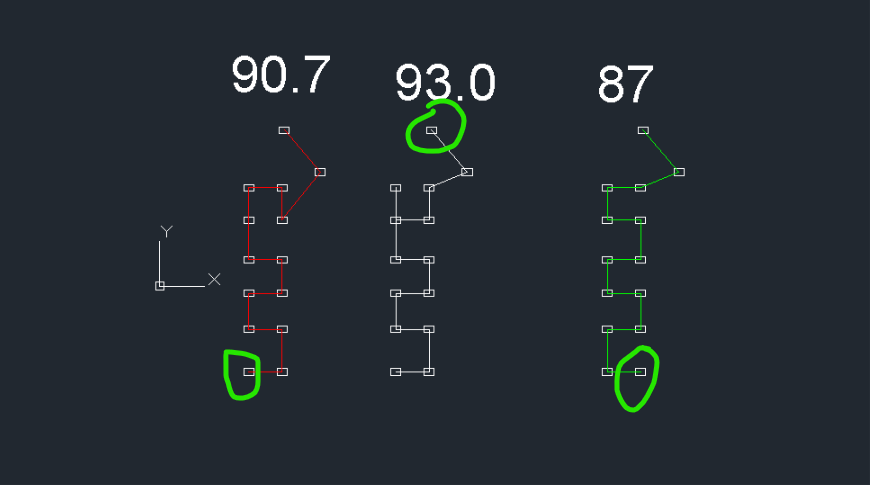

Connect selected blocks with the smallest polyline length possible
jtm2020hyo
the attached file (connect.lsp) connect selected blocks to their individual nearest block without repeat a link between them.
lisp request for a starting point then connects all block since there but depending on where you put the starting point the line can have different lengths.
(numbers in the image are the length of their respective polylines)
What I need is find the smallest polyline length possible that create a link connection between selected blocks.
like the image here
(number in the image is the length of their respective polyline)

Message 2 of 19
marko_ribar
I think that you are asking too much if there are more than 10 points... With each new point added computation required to finish the task grows geometrically, so like I said to @Anonymous you are practically doomed... The problem eventually collapses to TSP - Traveling Salesman Problem very known in computer science and it has no adequate solution that is fast and correct enough to be assumed that problem is solved... Problem existed from very long time and only approaches to answer this was through trying various greedy algorithms that may and may not be satisfactory...
Brute force method that is accurate for less than 10 pts can be found here :
http://www.theswamp.org/index.php?topic=54636.msg591196#msg591196
For more you have to dig that on your own, but I am afraid that very soon you'll be stuck with no solution...
HTH., M.R.

Message 5 of 19
jtm2020hyo
Basically that happens when you consider the number of possibilities of connections between blocks, right?
But the Lisp routine attached only general 1 lines per block. The lines that pass above itself should be discarded.
What I'm trying to say is that the solution must be to begin with For the blocks furthest from the geometric center (considering a boundary arround selected blocks with aa polyline hypotitica  that encloses all selected blocks)
I do not know if it is possible to detect the blocks furthest from the center but I only describe how I would solve the problem manually by myself. It's just an idea.
PD: If it is not possible to solve it with the furthest block, then lisp try use the second furthest, then the third.

An option to compare length between polylines created since "selected starting points" to next attached lisp (connect_blocks_all_option_bydbhunia.lsp) might be easier.
after active lisp-routine, lisp should show 2 options, the first to request to the user to choose a point, and another one that allows the user to choose some blocks/points (minimal 2) to create a polyline with this lisp individually, then comparing them and use the smallest polyline length.
the user just should choose the points that are furthest blocks/points of the center.
for example, in this image, I have 3 polyline lengths created with this LISP attached, block marked with green are points selected for the user. then lisp just should compare that 3 lengths to finding the smallest between them.

Message 10 of 19
marko_ribar
Both codes works the same way, and connect.lsp by me is faster than john's version... You added one imaginary point on your left example and starting point isn't the same... Sorry, but you haven't convinced me that your marked solution is correct... This is like I said just greedy algorithms attempts... Solution can't be found for more than 10 points... Real solution also should include beside checking for shortest overall distance intersections that may occur, like @dbhunia mentioned, and neither route.lsp nor connect.lsp check for this... Look in picture to see what I mean... You are cheating - see red circles...
Marko Ribar, d.i.a. (graduated engineer of architecture)
Message 11 of 19
jtm2020hyo
You are right. I did not noticed that Route.lsp generated a point from the biggest circle. (because route.lisp just link circles)
(file tested attached) In this image, I compared 3 lisp routines (route.lsp, connect_block.lsp attached named 'connect' in this image and connectblk.lsp attached and named 'connect-closed' in image). now and this is the result.
connect_block.lsp is the smallest length in this image. but connect_closed.lsp connect all points with a clear polyline. but routes did not the best here.
I already read that post from swamp.org, they are trying a mathematical solution, but in the real world does not have sense generate that unnecessary work for our CPU, because of obviously polylines that has the longest length always draw lines that going over other lines and vice versa.
I never thought to add an imaginary point to create the smallest line length. this is pretty interesting and is new for me. maybe creating an imaginary point might solve this issue.
 EDIT: route.lsp and connect.lsp should have the same result. but I'm that test did not happen. I don't know what happened there.
Message 12 of 19
jtm2020hyo
second test.
I can confirm that route.lsp and connect.lsp have same result.
connect_closed have the better result.
but I'm still impressed that an imaginary point can generate the smallest length.
ATTACHED tested file.
