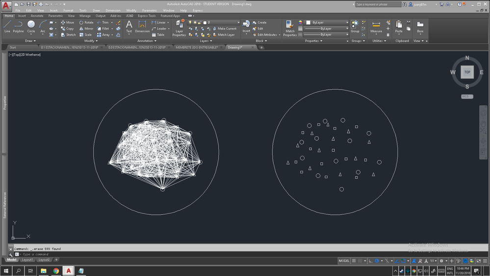

yes. something like that (in images). I can not make work that file, that vlx file just shows me next window:
...but I need something like that vlx try do.
I attached a lisp routine that works 50% how I need it.
Here is an example of how it works:
...as you can you see some polylines are going over other polylines. What I need is fix that.

there are more rules that I need add:
+the first rule, the blocks should be linked to the next nearest block no matter rotation or angle.
+the second rule, the LISP routine should work with dynamic blocks and regular blocks. (for some reason 20% of lisp routines that user does not work with dynamic block)
here an example using attached lisp routine (Connect_Blocks-all-option-by-dbhunia.lsp). red-polylines are what I need to fix.
 file, where I tested it, is attached.
