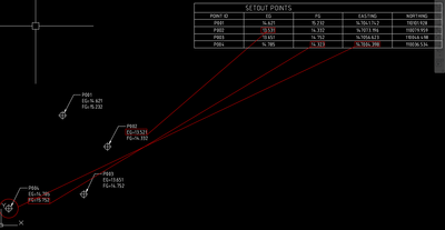

I want to compare the values of plans and table (exploded). Those that are not matching will be marked with polyline by selecting the Point ID.
see attached file and screenshot below
 You're happy with just showing what is not matching? what about Marked AND change ?

I guess we can do both, it's just a matter of changing the selection filter. I'll write the code for the UN-exploded table first.
As I started working on this today,  I came across DXF 110 on MLeader Context Data Group Codes. and on the OP's sample drawing, that value is the same as the insertion point of the block it's referring to. I use that for now as the reference value for EASTING and NORTHING value for comparison. Not sure if its the same for all or most of the 1000 points on the actual drawing.
Can you anyone explain 110 for me before I proceed with the building the code.

On this forum, you will get what you asked for marlance.
Pity I can only test this on your sample drawing, which only has a few objects to compare.
There is still a lot of work to do to make it run smoother. Like flag the objects not shown on the table, etc...
This version is for UN-Exploded table.
Command: ThistablesisNOTexploded
Select Table
Select Blocks & label

Wonder what happened to this request. The code I posted was meant to be funny ( no one is laughing :O, apparently not ), it is a literal solution based on the posted sample drawing.  I had fun writing the code though.
Screencast will be displayed here after you click Post.
27c0bf98-a859-4951-97e8-226c197b7180
In any case, I'm posting another one that updating the "table"   values and changing the color (could be commented if needed ). This time the table is exploded.
