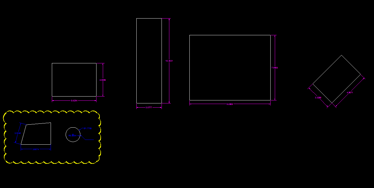

Message 14 of 14
I am thinking that, I am bothering you too much for my requirement. I don't know whether to mention so many times regarding this post.
I have applied this code to attached dwg, but it's not effecting to some nested blocks in master block. That I have highligted in a cloud mark. Can you pleas have a look on attached dwg and image.
Sorry for disturbing you too many times.
