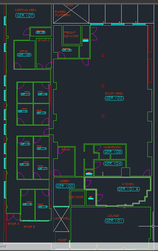

I'm trying to come up with a way to delete door arcs, extend across them, and form a boundary where I can measure the area. If the boundary is under a certain square footage then I want to delete it.

Really delete them?  Or just work around them?  What are they?  Arc entities?  Parts of Blocks?  Something else [I dunno -- Polylines maybe...]?  What about the door itself, apart from the swing arc?  Are the arcs on a different Layer than the door-itself elements, and/or the [presumably] wall elements?  What are the door-itself and wall elements drawn with?
Best idea I can think of:  have the doors [including their swing arcs] as Blocks, and include in the Block definition a door-head Line, on a different Layer.  Turn off  the door-&-arc Layer, and turn on the door-head Layer, and BOUNDARY or BPOLY should work quite cleanly.  Reverse that Layer on/off condition to restore to the ordinarily-visible plan elements.  [I find that kind of approach beneficial for other reasons, such as Reflected Ceiling Plans, which will use that door-head Line.]

I hope this will work for you! Use command BON to create boundary and to find its enclosed area. I have  tested it and it works ok for all cases , but in some circumstances it may fail. You may use command DLAST to delete last created object, modify my code for direct boundary erasure, or use what ever you fancy.

Thank you hak and Kent! I really appreciate the help. I am quite new to both Autocad and Autolisp, and have been banging my head trying not only to understand it but to implement solutions.
The bon function is very close to what I am looking for. The layer colour is green for simplicity for the desired output and I have also made it green for the current output.
All of the windows, walls, and so on are all on different layers and don't appear to be poly-lines, but individual entities. I am not sure if this is clear enough? I should clarify that I am receiving these files, and am not the architect of them.
In addition to this; I am looking to implement the following:
a) Delete all door arcs and replace them with lines from centre to end point.
b) Delete all windows and replace with a line segment in the long direction.
c) Copy all wall elements onto a new layer called "Boundary", along with the arc centre-end lines (one per arc) that join across gaps in these lines, and line segments replacing the window elements.
Maybe the pictures will better showcase what I am trying to accomplish here
