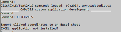

murugan.231123
When i apload the click2xls lisp it not working and reply that excel application is not installed.
Can anyone resolve my issue.
the same application is working other computer.
the excel is already installed.

vladimir_michl
First try the current version of Click2XLS from https://www.cadforum.cz/download - you have a very old one. If it still won't find your Excel, let's perform some diagnostics.

murugan.231123
Thank you for the reply.
I find the lisp from the website ...the new version...thank you so much.
But the issue is not solved.
Can you help the diagnostics part where i can get this in below.
Message 20 of 27
vladimir_michl
You can find it in the freeware section or using a search:
https://www.cadforum.cz/en/download.asp?file=XLS
Vladimir Michl, www.arkance-systems.cz  -  www.cadforum.cz
