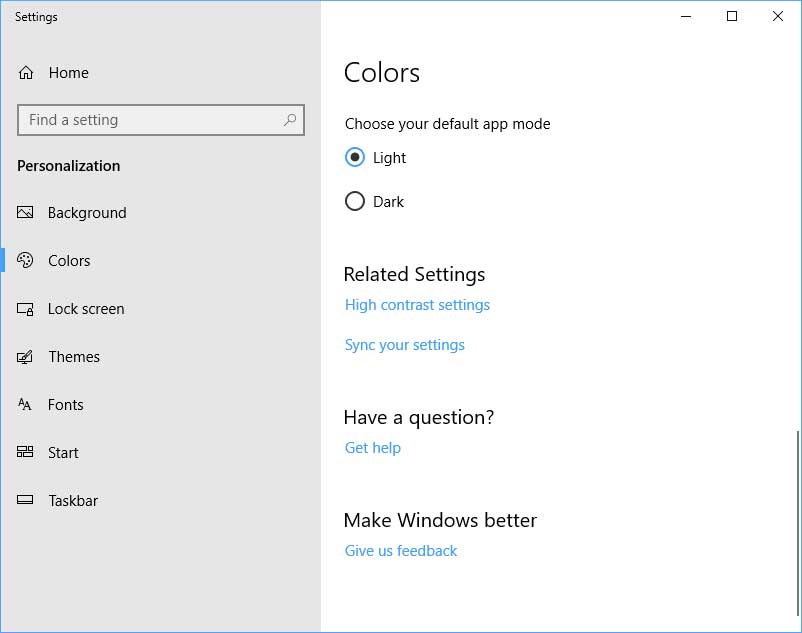

Enabling the Dark Theme in File Explorer and Windows 10
If you want to start using the new Dark Theme in File Explorer, make sure you are using the latest Windows Insider build, and then go into Settings, then Personalization, and finally Colors. Under the Colors settings screen will be an option labeled "Choose your default app mode" with "Light" and "Dark" options.
App Mode Colors Setting
Once you enable the "Dark" option, Windows will automatically enable it and the Dark Theme will be enabled in all support applications and interfaces, including in File Explorer.
Updated File Explorer Dark Theme

I followed the directions and changed to "Dark" in both AutoCAD and Windows.  Still have the grey-blue bar.  Everything else changed though.  LOL
