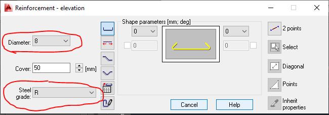

Hi!
I am using AutoCAD ASD 2015, and I need a LISP routine to change each bar color
by it's diameter and steel grade(R or T) .
like all T16 bars -green, all T18 bars -blue....etc.
thanks

Sea-Haven
Does asd add xdata to the objects ? Post a sample dwg.

Ismael2410
ASD.DWG sample.

Sea-Haven
The bars are proxy objects so that makes life harder, that as far as I got.

Kent1Cooper
@Ismael2410 wrote:
I am using AutoCAD ASD ....
If by ASD you mean AutoCAD Structural Detailing, there's a >Forum for that< where you may find a solution, or more people who can help.

Ismael2410
Thanks for help!
but AutoCAD Structural Detailing forum posting is closed and no longer working.
