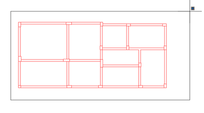

Hello guys;
How can I do automatic Trim the drawings I have given in the example?

You could also use the boundary command on the internals if the drafting is tight enough.

Ronjonp your right if its a mixture of lines and plines best way to go. Having done structural plans I would go back a few steps and draw it correct 1st go, but it sounds like k005 is getting it from some one else.
Some I have, draw brick piers, draw stumps, strip footings, waffle panels and so on. Working on a new slab on ground ie this post.

Here is my last attempt on this subject. This one required a lots of code changes and testing.
Attempt with breaking entities at point of wall column joint using break command failed miserably. Some other methods also didn't work or result was way too bad. At the end, with using various sorting and conditionals I've finished with this code. In some situations it works flawlessly, in other there can be some non erased or wrongly erased entity belonging to columns. Code is a bit generalized so it asks to select some entities to extract layer name for columns (so other users can use it). After code execution, all entities remain in its particular layer.
Requires that columns and walls are drawn in separate layer.

Usage is simple. Start command, pick two points outside all entities to create window selection, pick an entity (a polyline) on columns layer to extract name of layer and that's it. Sorry don't have time to work on video.
Stage 1Stage 1
Stage 2Stage 2
Stage 3Stage 3
 After final editing i.e erase or add some column member (all breaking points are correct, but sampling right entity to erase is complex and may fail in some case
Stage 4 After cleaning remainsStage 4 After cleaning remains
Failure at the end are result of algorithm complexity and potential errors, too many variables involved and conditions to test and Murphy's law.

			(setq ss_wall (ssget "_W" p1 p2 '((0 . "LWPOLYLINE")(-4 . "=")(70 .  0))))
			(setq i -1)
			(while (<(setq i (1+ i)) (sslength ss_wall))
				(setq e (ssname ss_wall i))
				(setq wo (vlax-ename->vla-object e))
				(setq pointlist (cons  (vlax-curve-getStartPoint wo) pointlist))
				(setq pointlist (cons  (vlax-curve-getEndPoint wo) pointlist))
			(setq pointlist (unique pointlist))
			(setq i -1)
			(setq delpoint nil)
			(while (<(setq i (1+ i)) (sslength ss_kol))
				(setq k (ssname ss_kol i)  ko (vlax-ename->vla-object k))
				(setq points_on_column nil)
				(foreach ept pointlist
					(if (<= (distance (setq np(vlax-curve-getClosestPointTo ko ept nil)) ept) 1e-3)
						(setq points_on_column (cons (take 2 np) points_on_column))
				(cond
					((and points_on_column)
						(setq pts (pointlist2d (vlax-get ko 'Coordinates)))
						(setq pts (append pts (list (car pts))))
						(setq j -1 seglist nil)
						(while (< (setq j (1+ j)) (1- (length pts)))
							(setq seglist (cons (list (nth j pts) (nth (1+ j) pts)) seglist))
						(foreach seg seglist
							(setq s1 (car seg) s2 (cadr seg) onseg nil)
							(foreach pt points_on_column
								(cond
									((collinear s1 s2 pt)
											(setq onseg (cons pt onseg))
							(cond
								((and onseg (= (length onseg) 2))
									(setq delpoint (cons (mapcar '* (mapcar '+ (car onseg) (cadr onseg)) '(0.5 0.5)) delpoint))
						(setq pts (append pts points_on_column))
						(setq pts (apply 'append(vl-sort pts '(lambda (x y)(< (vlax-curve-getDistAtPoint ko x)(vlax-curve-getDistAtPoint ko y))))))
						(vlax-put ko 'Coordinates pts)
			(initcommandversion)
			(command "_.explode" ss_kol "")
			(setq ss_kol (ssget "_W" p1 p2 (list (cons 0 "LINE")(cons 8 col_layer))))
			(command "_.pedit" "m" ss_kol "" "Y" "")
			(setq ss_kol (ssget "_W" p1 p2 (list (cons 0 "LWPOLYLINE")(cons 8 col_layer))))
			(setq i -1)
			(setq ss_del (ssadd))
				(setq mpt (mapcar '* (mapcar '+ (vlax-curve-getStartPoint ko)(vlax-curve-getEndPoint ko)) '(0.5 0.5)))
				(foreach ept delpoint
					(if (and
							(<= (distance (setq np(vlax-curve-getClosestPointTo ko ept nil)) ept) 1e-4)
							(> (distance mpt(vlax-curve-getClosestPointTo bo mpt nil)) 1e-14)
						(setq ss_del (ssadd k ss_del))
			(command "_.erase" ss_del "")
			(entdel be)
	(setvar 'cmdecho 1)
	(vla-endundomark adoc)
	(princ "\nDone!")
	(princ "\nCheck drawing for possibly non erased or wrongly erased entities at columns and walls joints!")
	(princ)
Miljenko Hatlak
Message 28 of 30
k005
@hak_vz
Thank you very much. Both codes you have posted last work.
I think I have a problem with my computer or AutoCAD. A lisp related to the bpoly command doesn't work either...
* I did my last Trials on another computer . and I got the correct results.
Thank you so much. Friend. 🤗
Message 29 of 30
hak_vz
The reason that my first code didn't work for you has moved me to started working on this code. At the end I needed to use bpoly to create outside wall boundary (unable to remove elements from outer column side to be erased.
Option would be to draw outer wall edge as closed polyline and select it as a boundary. In that case bpoly is not needed. First of all you have to check your installation.
Miljenko Hatlak
Message 30 of 30
k005
it is true. I did not encounter any other problem. But now I will refresh the installation. Thanks.
