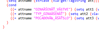

I ve tried several times, but it always showed some sort of error.. like "not enough real parametrs" or something like that " then i tried to do other stuff with it until it made mtext (it is in attachmets).

ВeekeeCZ
Here's how to set these two variables correctly
(setq ptList (vlax-get ent 'InsertionPoint))
(setq pt (vlax-3d-point ptList))
The Mtext version should work as is, but it's better to rename the acad sys var to, e.g.acadobj. acad is a protected symbol.
FYI, this is why you should NEVER use diacritics in important identifiers as att tags are.
