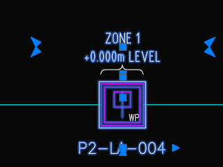

I currently export a CSV file from a config file, from which it lets me know what devices I currently have on a network....
Cell A = Node ID
Cell B = Line ID
Cell C = Device Address
Cell D = Type
Cell E = Description
From this I normally build up a schematic manually, select the block for the device type then change the Node ID, Line ID, and Device Address attributes, N1/L1/001 for example, thousands of times over...
This is easiest the longest document of my projects and I have been looking for an easier solution.
I have limited understanding of python so that was my first avenue, but came up short of anything already out there that I could easily adapt.
Is there anything already out there I could try or a different avenue to learn? lisp for example? VB?
Ideally I would want a script to automatically generate a line schematic based off my already generated CSV file,
for example
Type 1 places block 1 with attributes in cells A1-C1 in "x" position 100
Draw line 100
Type 1 places block 1 with attributes in cells A2-C2 in "x" position 300
Draw line 100
Type 2 places block 2 with attributes in cells A3-C3 in "x" position 500

Post a sample drawing of your drawing schematic. Reading CSV files is easy peasy 🙂

This schematic is a bit disjointed with MTEXT and ATTRIBUTES ... why are you not using attributes for all the information?
Message 8 of 13
I just quicker to change the text with the MTEXT, no problem using the ATTRIBUTES though.

Go straight to excel as I suggested "next next request", do really need a xls file what happens when pattern is repeated for more than 1 segment ? Looks like a good delimeter to look for. "Loop Devices" as you say may be a xml file again multiple segments.

Looks easy enough, But how did you come up with that sequence? What is the block name, position and distance from this info?
#PanelID Loop Address Zone Type Description
1 LA 1 1 WPMCP +0.000m LEVEL
1 LA 2 2 WPMCP +5.000m LEVEL
1 LA 3 1 LPSB +0.000m LEVEL
