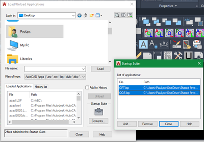

So I found CFT.lsp which converts Fields to MTexts
Save both CFT.lsp & QQS.lsp to a folder that's in your AutoCAD's Options>File>Support File Search Path & Trusted Locations.
Then load QQS.lsp:
(load"QQS")
Then run the new command added:
command: QQS
Let me know if it works for you.

I added both the CFT.lsp and QQS.lsp to the startup suite and these are the first observations that I made.

5. Not sure why you have to manually enter (load"QQS") each time when a drawing is opened since you already placed both CFT.lsp and QQS.lsp to automatically load in Appload's Startup Suite. Perhaps you can do a screenshot of your Appload's Startup Suite and share that here like I did below:
