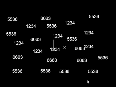

Is there an auto lisp program that can wipe the same text (numbers) in different places of the drawing and leave only one no matter where it is. For example, I have the number 2626 that is in the drawing in three different places and I want to leave only one without looking for where the rest are in the drawing. for example two duplicates 2626 should be found among a few hundred other numbers.
Thanks.

DannyNL Just what you said. I want to select all the numbers at once. In picture 001 I have an initial situation, for example number 5620 appears four times. and I need the situation as in pic 002. Unfortunately, when I launch your program I get the following message:
Command: TEST
; error: no function definition: VLAX-ENAME-VLA-OBJECT
Maybe because I have AutoCad 3d 2012 ???
Message 9 of 19
Just like you said Danny, I want to select all the numbers at once and the program clears all the duplicates and leave only one, no matter where it is. In picture 001, I have an initial situation and, for example, the number 5620 appears four times. And I need the situation as in Figure 002.
Unfortunately, when I try your program, I get the following message:
Command: TEST
; error: no function definition:  ( VLAX-ENAME-VLA-OBJECT)
Maybe this is because I have Auto Cad 3D 2012
