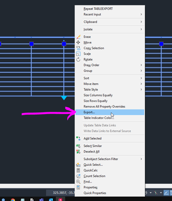

I'm trying to export a manually created AutoCAD table to CSV format as shown in the images above.
I have a LISP routine (downloaded online) that works same like I needed but it exports the data to an Excel file (xlsx).
please help me modify the LISP routine to export data to a CSV file instead?

Message 2 of 12
pendean
Community Legend
Community Legend
@vishalghuge2500 wrote:
...modify the LISP routine to export data to a CSV file instead?
May I ask why the built-in feature to do just that is not an option?

Message 4 of 12
Sea-Haven
Just a clarification for future, a "Table" is a CAD object that contains a grid of cells with values, think Excel, what you have is columns of text with surrounding line work. Komondormrex has given you a great answer. Very simple method added to "may need in future" also added acknowledgement to author at start of code.
Message 5 of 12
vishalghuge2500
Thank you @komondormrex  for your help. Your code works very well.
