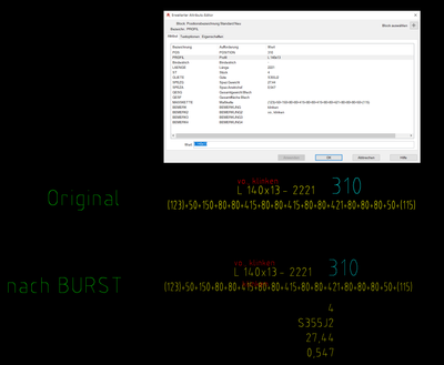

how can I explode the visible and simultaneously filled attributes from one / more block references into texts with the same formatting (original properties)? Unfortunately, the result cannot be used with the EXPLODE command. After using the command BURST, unfortunately all filled (visible as well as invisible) attributes are converted into text. Since there are a lot of such and similar blocks in my drawings, where the texts (after being explode using BURST) still have identical properties to other objects (layers, etc.), a later selection is impossible to include the unwanted texts (originally invisible attributes) to delete.
An example with the command BURST -  requested form should be identical to the original:
above is the original block with property manager
below is the result after BURST command
Thanks in advance for ideas

The simplest way may be to just read the attributes and their properties and say make MTEXT of what is required.
Use Vl-get-attributes
I need ti explode all visible attributes only from all blocks in to text. MTEXT is not necesarry, because all the texts stay in the same position (see my original block in the picture).

Ok, today without any informations, just a link: Try this: Click!
Sebastian
pbejse
Try this from Lee Mac
Upgradedburst by LM
