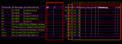

Hello. We need a lisp to change every line of a table into attributes. In other words, every line of the table should be a group of attributes. Attribute text must have a designated layer. Attached, you can find the sample file. Does anyone have something like this, or interseted in writing it? Please let me know. Thank you.

1b-gzde
Screenshot_1.png This is my table
Screenshot_2.png This is how it should be. (Has desired layers and attributes)
Screenshot_3.png This shows all desired attributes. I have also added dwg file to make it clearer.

I tried the new version. I uploaded the results. Columns "Einh", "WiLI", "WiRE" comes as default, however they have their own values. Also, it doesn't include these marked columns. Is it possible to add them, too? They sometimes have values.
Sure it is. See my first reply, YOU need to fill the list with all the rest of the attributes. I did just a few to prove the concept and show you the syntax, but the rest is just repetitive task.
