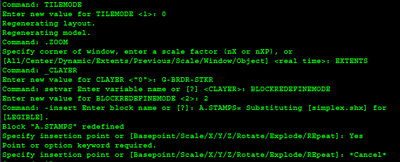

In my drawing, there is a block called a.stamps that I am trying to redefine with a wblock that exists in my block library. I am trying to update this block in several hundred acad files.  The block definition in my test drawing will not update. Please help!
this is my code...

@thomas.stansell wrote:
-insert "C:\Users\bmn932\OneDrive - AFRY\_JERVOIS\133001042JER\CAD\P&ID's\CAD RESOURCES\ACAD BLOCKS\A.STAMPS.DWG"
If you can put that filepath in your Support File Search Path list in OPTIONS, and if the Block name is the same as the external drawing file name, then that line can be replaced by just:
-insert A.STAMPS= Yes
The Yes is to answer the question of whether to redefine the Block.
[By the way, you don't need to include the .DWG filetype ending -- it won't consider any other kind of file.]

@Kent1Cooper I did what you said...at least I think I did...please take a look and tell me where I messed it up?

Kent1Cooper
Remove the Yes answer -- it's not asking whether you want to Redefine it.  I don't know whether that's because of the BLOCKREDEFINEMODE setting [the description in Help doesn't look like it should be the reason], or just a difference in the operation when in a Script, or maybe your EXPERT System Variable setting prevents it.

Thank you so much @Kent1Cooper that did it!
