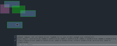

btw you can try yourself what vertices you've got to work with:
(mapcar 'cdr (vl-remove-if-not '(lambda (x) (= (car x) 10)) (entget (car (entsel)))))
copy/paste it into the command-line.

Shapes are quite simple in test file, see area 1 below
Hatches have their centers inside areas
But labels are in hell, yes, see area 2 below
adding (cdr................) didn't effect unfortunately

The code (mapcar 'cdr (vl-remove-if-not '(lambda (x) (= (car x) 10)) (entget (car (entsel))))) in command line ask me to select the object, after picking the hatch result tells me nothing talking true
