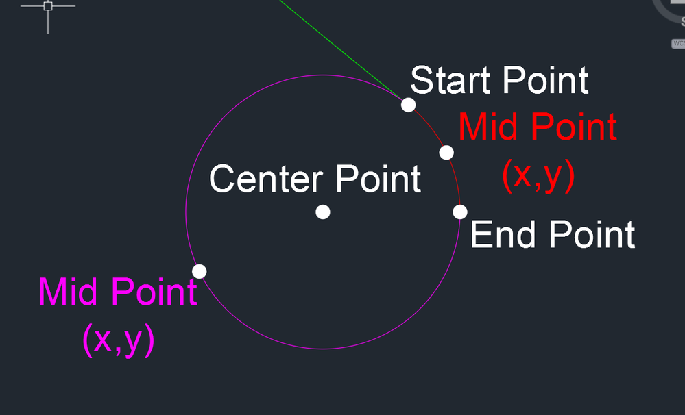

Yes, I know that. But imagine that I have exported just a coordinates of arcs (StartPoint, MidPoint & EndPoint) and when I look at the excel worksheet, I don't see anything but the numbers which can help me to re-create all arcs again, but in Inventor. What would be the key parameter which will help me to re-create arc. Maybe coordinates of midpoint?
For example, these two arcs (red & magenta) have the same start,end and center point but not the same midpoint. Maybe by arc's midpoint I can be sure that right arc is re-created. Any other opinion?

_gile
Assuming arcs are always conter clockwise, with Center Point, StartPoint and EndPoint as in the picture, you'll get the magenta arc.
To get the red arc, you have to swap StartPoint and End Point.

_gile
Please, explain how you get the arcs data in AutoCAD and which data are exported to Excel, in all your examples, you need more than 2 points to define the arcs, at least a radius and probably the arc center.
With AutoCAD, an arc is typically defined by a center point, a radius, a start angle and an end angle (and possibly a normal -or extrusion direction- if it does not lies on the XY plane).
These data are necessary and suffisant to define the arc.
They can be computed from 3 points:
  • a point at one end, a point at the other end and a point somewhere else on the arc in this case the topography will determin which point is the start one and which is the end one so that the arc is conter clockwise.
  • a point at center of the arc, a start point and a end point, in this case, the arc will start at start point and go conter clockwise to end point.
