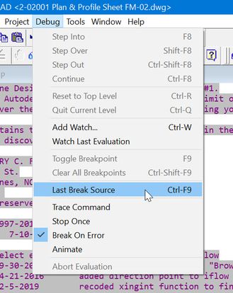

If you open the visual lisp IDE (Command VLIDE), turn on "break on error" under the debug menu, and then go back to AutoCAD and rerun the AECLAY it will open VLIDE when the error is encountered. Under the debug menu, select "last break source". That should open the offending file. Then you should be able to determine where it's located.
