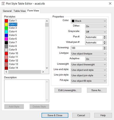

S_S_SS
  First i need to add a printer setup name "acad2" as shown in the first image
this acad2 change the color yellow  to black on the pdf as shown in the second image
and i need the exported pdf in the same location with the dwg file and have the same name but add "acad" in the last of the name of the pdf file as shown in the third image
and thanks in advance about that

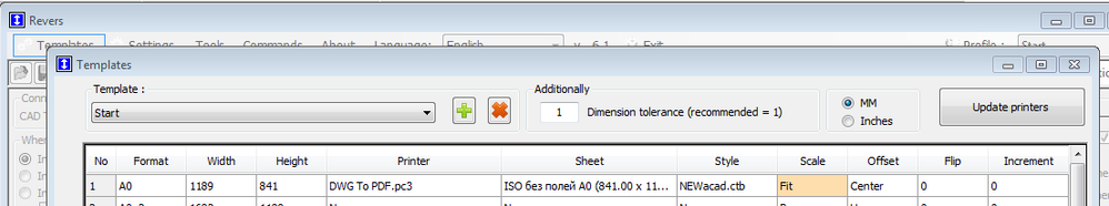

Message 10 of 14
maratovich
Run the program setup once:
1. Plot style table - select "New".
2. Create a new one - name "NEWacad.ctb"
3. When creating - "Print Style Table Editor"
4. Specify for yellow - black.
5. Set the checkbox - "Use table for new and previously created"
6. Press the "Finish" button.
7. The new style will appear in the table list.
photo 1
8. Restart AutoCAD. Open your files (20-112-EGY-ANOPIC-UNIT 1A01).
9. Start Revers.
10. Open the Template tab.
11. Click the "Update printers" button to get a new "NEWacad.ctb"
12. Fill in the template table.
photo 2
Set filename :
13. Open the Settings tab.
14. Select Publish to PDF
15. In field 30-"user text" enter "(ACAD)"
16. In the "file name" field, enter "10-30" this will be the file name and user text
17. In the field insert between - enter " " a space.
18. Specify the location to save the file - next to the file.
photo 3
18. Save settings.
Seal :
19. In the main window, click Revers - Find all formats
photo 4
20. Press the button - Publich to PDF.
Ready.
