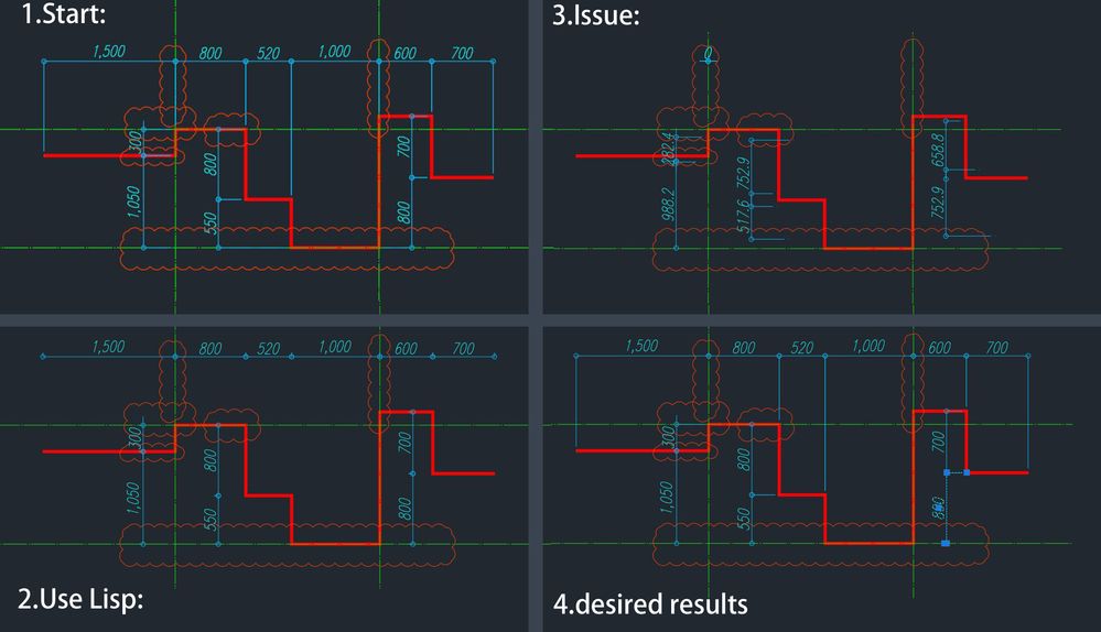

Hi!
This is my first time posting. Although I found a lot of solutions to my other problem. However, this time I have not found a suitable solution to this my problem.
I have 2 problems: Extend line and Dimension text.
1.Extend line: [IMG1]
-I use the attached Lisp to "trim" ext Lines. (select the parallel and linear dimensions. And specify the position of the line pins) No2-IMG1.
-The Cons of this lisp. when specifying the line foot at the dimension line. then re-command will cause the dimesion jump. No3-IMG1.
>>> I want to select all dimensions (Rotated and Align dim ..) and change the length of the Ext lines to 0 or very small. So that it does not overlap with other lines. Then possible for change extline again . No4-IMG1.
>>> It is possible to change the Ext line length after setting length = 0. And it is possible to change the  extline for all or one by one.
2. Dimension Text: [IMG2]
- For small distances. Dimension will overlap with other lines. I made a manual move to drag it to the sides (Left, Right). No2-IMG2.
-When mirroring these dimensions. It will be below the dim line. I have to move it manually or use the command "Ai_Above_DimLine" one by one and cannot be used for multiple dimensions at the same time. No3-IMG2.
>>> Is there any solution to choose the position (Left, Right, Mid, Top, Bot ...) like justify of text compared to the Ext lines. And can Adjustment offset position (with arrow button for example)
>>> It is possible  command "Ai_Above_DimLine" for all dim or selection.
 Thank in advance. Have a good day.

@Vuxvix  hi,
for your first request check this one. for the second i think your problem is the dimstyle or you moved the dimtext and AutoCAD is 'committed' to do exact mirror. use DIMTEDIT Home and if it does not work post a sample dwg.
enjoy
Moshe

Vuxvix
This is really good news to start the new year. Thank you very much, this was of great help to me. May I to invite you to have a cup of coffee.

Kent1Cooper
-I use the attached Lisp to "trim" ext Lines. (select the parallel and linear dimensions. And specify the position of the line pins) ....
If I understand correctly that you want to not have extension lines drawn through gaps in non-continuous other lines such as center-lines, you don't need to move their definition points -- you can suppress the extension lines.  I wrote DimExtLineToggle.lsp, with its DET command, to toggle the nearer extension line of any selected Dimension [off if it's on, on if it's off].  You can pick on the extension line itself if it's on, to turn it off, but in this case, if it coincides with some other line, you can pick on the arrow, or the dimension line, or even the text.  And that allows you to toggle one on when it's currently off and you can't pick on the extension line itself.  The routine finds which end you picked closer to, and toggles the appropriate extension line, and you don't need to know which one if #1 and which is #2 [as you would if you do it in the Properties palette].  If that will serve your purpose, you can find it >here<.
Kent Cooper, AIA

Moshe-A
@Vuxvix  hi,
Here is a command DTM (Dimension Text Move) to move the text above or under dimension line
for this i needed to use some beautiful functions by great Lee Mac - thank you very much LEE 👍
 b.t.w for the previous command DLE, if you specify a negative, value the extension lines will flip 😀
enjoy
Moshe

Vuxvix
First of all, many thanks for your support!
I have tried your DTM lisp. it works fine for those set to "right place". I mean, in case the Dimtext is moved left (or right, whatever ..) but is too close (or overlapping) to the Dimline. Then DTM is making a mirror (axis is Dimline). In the attached picture, there are a few dimtext overlapping with Dimline.
Forgive me, Is it too much to expect an update to the DTM lisp?DTM Lisp fix.JPG

Moshe-A
post a sample dwg with a state before dtm and after so i can see the issue
Message 10 of 14
Vuxvix
In the file is my example. thanks
Message 11 of 14
Moshe-A
@Vuxvix ,
Before you use DTM, you need to fix the relevent dimstyle, sets all dimvars the correct value until you reach a proper dimension line + use dimedit home option...it looks like your start is wrong and DTM is not supose to fix that.
all DTM does is moving the text around the dimline (using dimline as an axis)
Moshe
