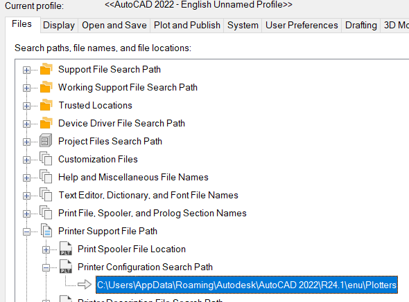

Type inside AutoCAD OP or Config and on the Files Tab see if you have the path right to find your .PC3 files.

@jrreid  I think you misunderstood my question. I can see the pc3 files from Autocad, just not from accoreconsole. The path is correct. It just seems to be disregarded somehow when loading them from accoreconsole.

The .pc3 path is "C:\Users\CAD1\AppData\Roaming\Autodesk\AutoCAD 2020\R23.1\deu\plotters" in this profile.

(princ(getenv "PrinterStyleSheetDir"))
(princ(findfile "mypersonal.pc3"))
and check the log
Sebastian
Message 9 of 10
ottosson_mathias
Thanks a lot! I found the issue, much thanks to your help. Especially (princ(getenv "PrinterStyleSheetDir")) which lead me to getenv "PrinterConfigDir" which showed that the path was set to a folder that didn't exist. Some default folder in the Autocad install folder (C:\Program Files\Autodesk\AutoCAD 2020\plotters).
