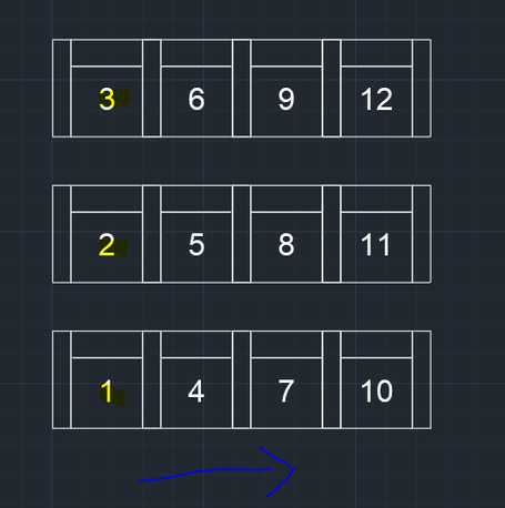

Is there any way that I could do coding in VBA to insert automatic numbers inside an array of blocks?
If you can see above, I'm manually putting text to indicate the number, I want that if I select the array it will be automatically numbered. can anyone help me how to do it in VBA, please take note that I'm new to this VBA, I'm eager to learn about it.

zka192020
Hi @grobnik, actually I don't need the associative array, it just when I array it automatically turn on the associative array. Normal array would do for me. Thanks.
Message 6 of 12
zka192020
Hi @norman.yuan, actually I don't need the associative array, I understand the step given by you, but I don't know how to convert it into VBA coding, I'm new and still learning about VBA.

zka192020
Hi @grobnik,
Sorry for the late reply, I'm on holiday. Thank you so much for your code.
I understand a bit now how to do it, but when I try your code, the number goes up from row to row.
Can I know how to change it so that the number can be in the arrow direction.
Thanks a lot @grobnik
Message 9 of 12
zka192020
Hi @grobnik,
Another one I found from your code is that the number is based on the total qty, but actually what I want to do is every row start with number 1 (refer pic below). But can I do that the user input the starting number? For example as you can see from the last row, the number start from 3, because it doesn't have same qty of seat as per the other row.

Hi @zka192020
As I wrote "Please note that the number sequence associated to block will be the same as insertion block sequence."
Probably when you inserted the blocks it was in row sequence
You can refine the code, you can get help from forum.
For user input integer you can try intUserIntegerInput = UtilityObject.GetInteger([Prompt]) and then pass the value to insert text function.
