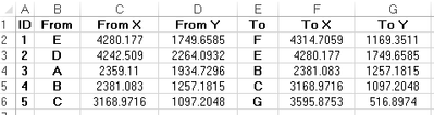

Dear Experts,
Please help me in Providing code for Excel VBA to draw network using the data in Excel Sheet.
I have two named points with X,Y Coordinates - task is to draw a circle with mentioned radius in VBA at the points and insert text at the same point, also a line to be drawn between points (From to To).
Data is in Excel attached, Sample output is attached in AutoCAD file.
Also request for Error Handling (if X,Y in FROM or TO is missing  - VBA should skip the line and continue for the rest - i mean should not stop at that missing line)
I could achieve Circle and Text through VBA but inserting lines through SCR file - i want it in one combined VBA Code.

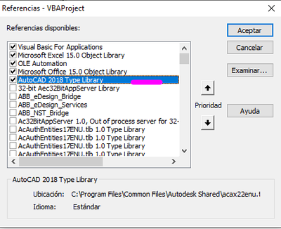

SOLO CARGA LA REFERENCIA DE TU AUTOCAD
MODIFIQUE TU TABLA UN POCO, NO PUEDO SUBIR LA HOJA CON LA MACRO, CUAQUIER DUDA CONTACTAME
SALUDOS

Dear Mr. j.cordero
thanks for the Code it helped me a lot,
Just one point missing, as i have asked for "error found - skip line and continue", its not happening and if my ID 4 line is missing then entire process is stopping at ID 3 and not considering values in ID 5,6, and hence forth.
Please update the code for the same.

Para que funcione no debe ver ningún espacio en la columna ID, esa columna controla las veces que se ejecuta la macro y al encontrar un espacio se para.
