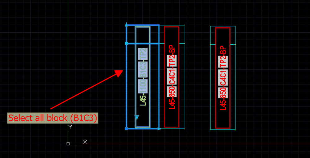

magicdl96
hi all,
I have a block and I use insert field in it. I want to select all blocks with insert field as B1C3.
I have the following code but I don't know how to choose them.
Sub SelectBlocksField()
Dim atts As Variant
Dim AcadObj As AcadObject, BlockRef As AcadBlockReference
Dim att As AcadAttributeReference
Dim ssetObj As AcadSelectionSet
For Each AcadObj In ThisDrawing.ModelSpace
    If TypeOf AcadObj Is AcadBlockReference Then
   atts = AcadObj.GetAttributes()
   For i = 0 To UBound(atts)
        Set att = atts(i)
        If InStr(1, att.TextString, "B1C3") Then
                'Select what ??
        End If
    Next
    End If
Next AcadObj
End Sub

Message 8 of 24
magicdl96
Thank you for telling me I understand so I can better express what I want.
what i want here is to select all block whose insert field is B1C3 (highlight it so it can be moved, copied or checked position in drawing)
similar to how we use the left mouse button to select objects.

Message 14 of 24
magicdl96
sorry I reply long time.
as i said: what i want here is to select all block whose insert field is B1C3 (highlight it so it can be moved, copied or checked position in drawing)
My purpose is to select those blocks to check their location in drawing is correct or not.
Message 15 of 24
