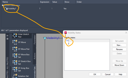

Hi all, i am trying to get all Visibility States (1 and 2) of parameter "Visibility1" of dynamic block.
Show message box for example.
Any one have example code?

tim11_manhhieu
i found it. vba code for who need.
Option Explicit
Sub ListVisibilityStates()
    Dim blockRef As AcadBlockReference
    Dim visProp As AcadDynamicBlockReferenceProperty
    Dim visProps() As AcadDynamicBlockReferenceProperty
    Dim entity As acadEntity
    Dim basePoint As Variant
    Dim state As Variant
    Dim i As Integer
    On Error Resume Next
    ThisDrawing.Utility.GetEntity entity, basePoint, "Pick dynamic block: "
    On Error GoTo 0
        If TypeOf entity Is AcadBlockReference Then
            Set blockRef = entity
            If blockRef.IsDynamicBlock Then
                visProps = blockRef.GetDynamicBlockProperties
                    For i = 0 To UBound(visProps)
                        Set visProp = visProps(i)
                        If visProp.PropertyName = "Visibility1" Then
                            For Each state In visProp.AllowedValues()
                                MsgBox state
                            Next state
                            Exit For
                        End If
                    Next i
            End If
        End If
End Sub
