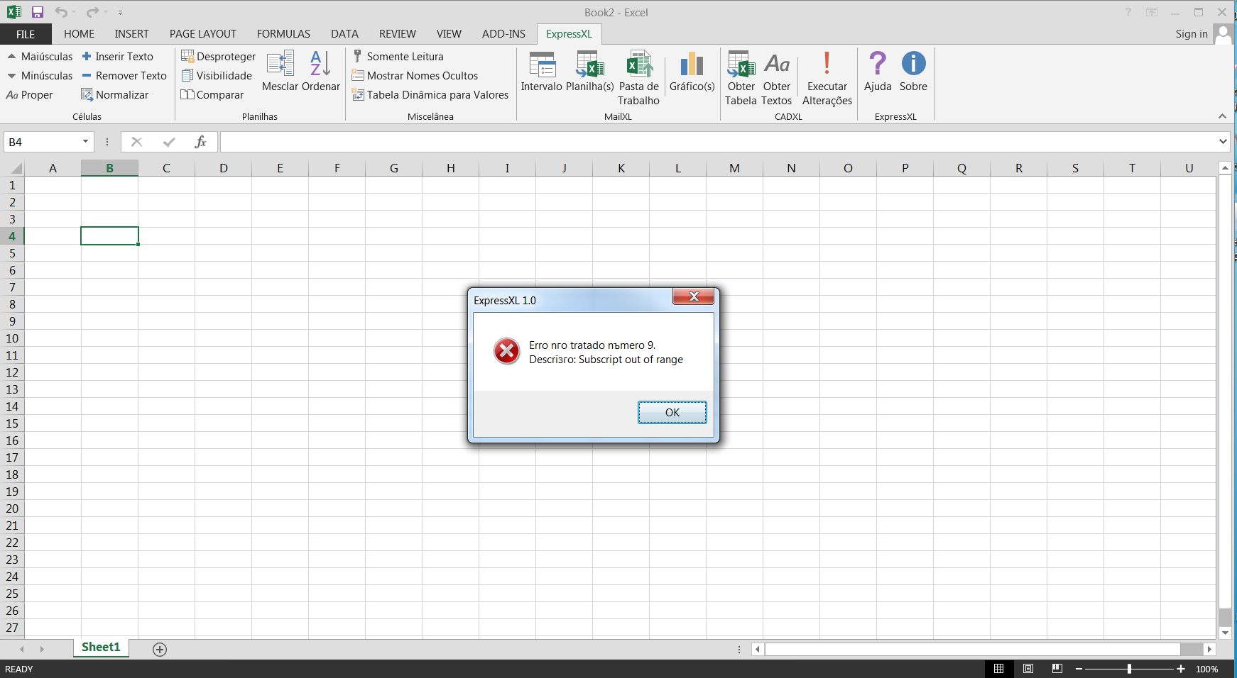

Message 12 of 20
Hello all,
Thank you for you patience.
The CADXL is completely remodeled, and now it is part of a much bigger addin. Please test it by downloading at http://www.ambienteoffice.com.br/excel/expressxl/
Any questions can be posted here. I'll answer!
Regards,
Message 13 of 20
Hi Felipe,
Thank you for your tme and effort.
The Acad part of the macro is working partially - I can extract the text, but I  couldn't export the table content to Exel.
See the attached pictures, if they may be of any help to solve the problem.
Once again, thank you for your effort,
Cheers,
NN
