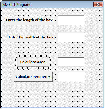

AutoCAD 2012 is loaded on my office machine with WIndows 7 64 bit.  I have downloaded the correct vba module and installed.  After writing a simple program with two texboxes for user input and a calculation button with an answer box,  when running the cursor appears in the textbox but neither textbox will  accept input from the keyboard and the cursor does not move nor does the tab key work even with it set in the program.  Pressing the calculate button and a zero appears.  Any help would be deeply appreciated. In the toolbox I have added the AcFocusCtrl control, still no luck.

I teach the very basics of coding with VBA in AutoCAD , so the following code is for one button to calculate and place an answer in the Anstxt textbox.  When I run the program and try to type in a length or width, nothing appears in the textbox.  I have added the AcFocusCtrl control, but nothing happens.  Do you know of any problems with the VBA enabler and AutoCAD 2012?  I am running WIndows 7 Professional.  Also I noticed that when I click on a textbox to type in a number and then click the second box, I can see the cursor moving in AutoCAD.  When I click again on the program it regains control of the cursor.

In general adding an acFocusCtrl to the form solves the problem. In your case, you did mention that you added acFocsCtrl and it stil did not work. However, in the Userform picture you attached, I do not see there is an acFocusCtrl.

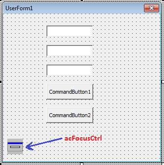

See my UserForm picture here:
Before I drop the acFocusCtrl on the form, I cannot type into TextBox and need to click twice on a button. After drop the acFocsCtrl, the UserForm works as expected.
IMO, even VBA form works with the help of acFocusCtrl, it is definitely not worth investing time/money to learn Acad VBA.
