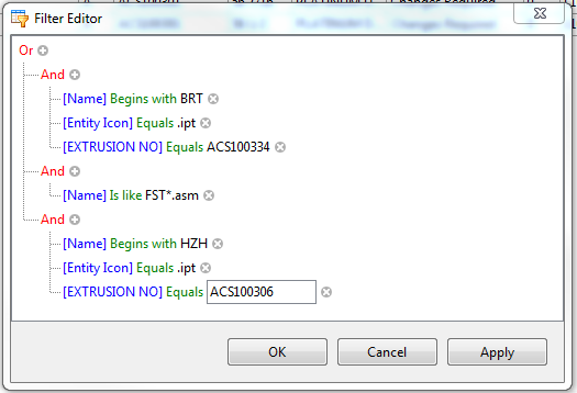

Currently the saved search criteria acts as an AND operator.  There is no OR operator in the saved search criteria.  It would be nice if there was a way of implementing a search criteria similar to that of the filter settings.  There is a lot more functionality in the Filter editor than in the saved search criteria.  I can create much more complex searching criteria with this.
This search would then return:
  • BRT Parts of EXTRUSION NO - ACS100334
  • FST Assemblies
  • HZH Parts of EXTRUSION NO - ACS100306
Currently you would have to have 3 separate saved searches. one for each AND line.
